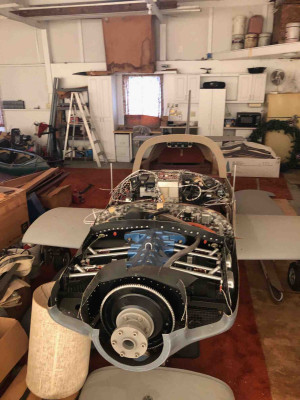

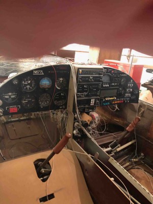

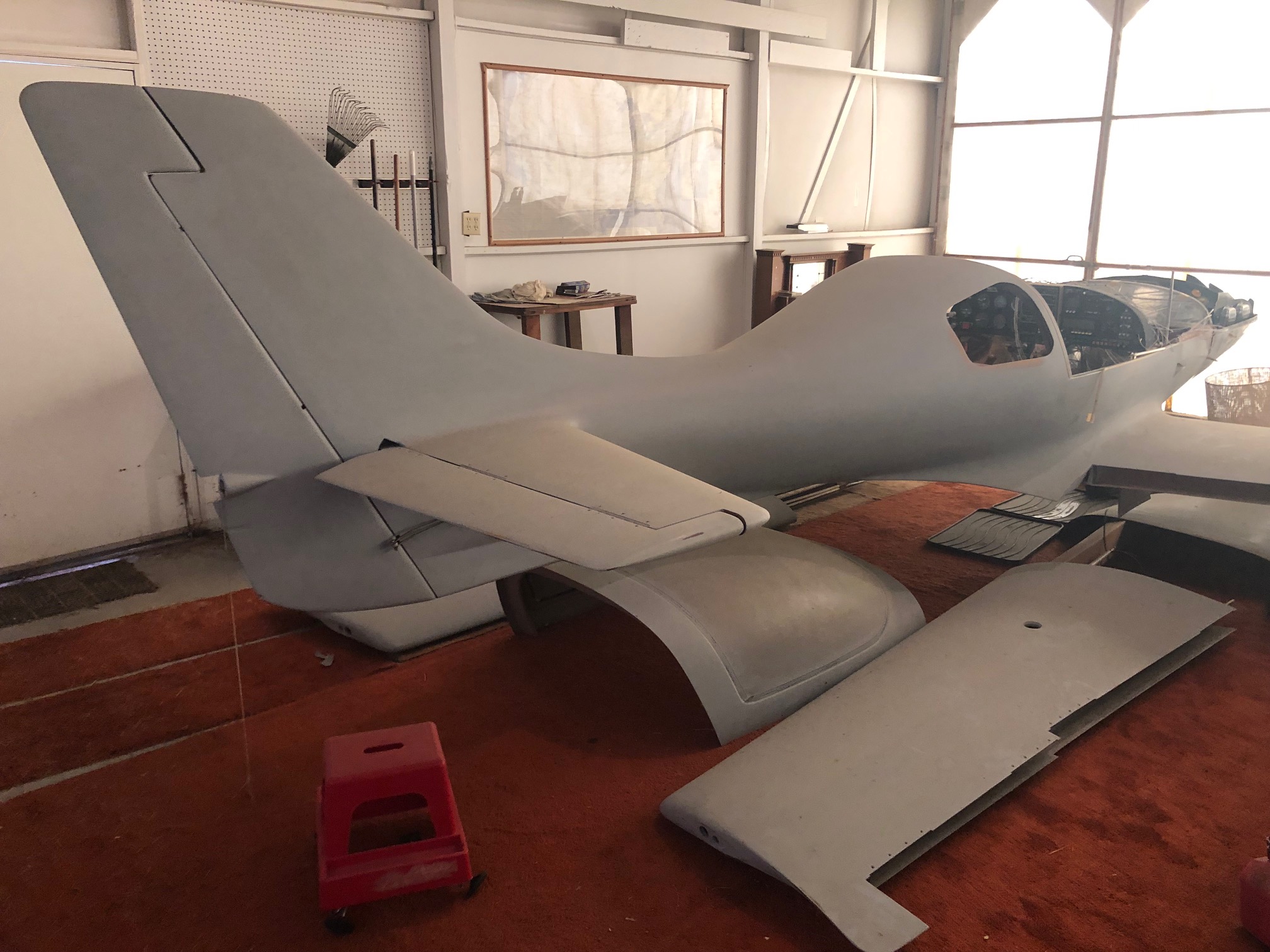

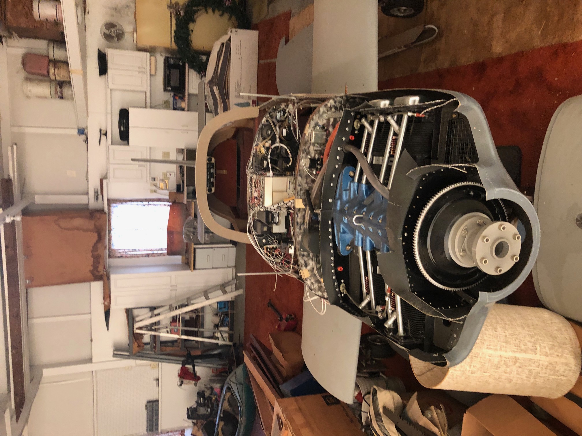

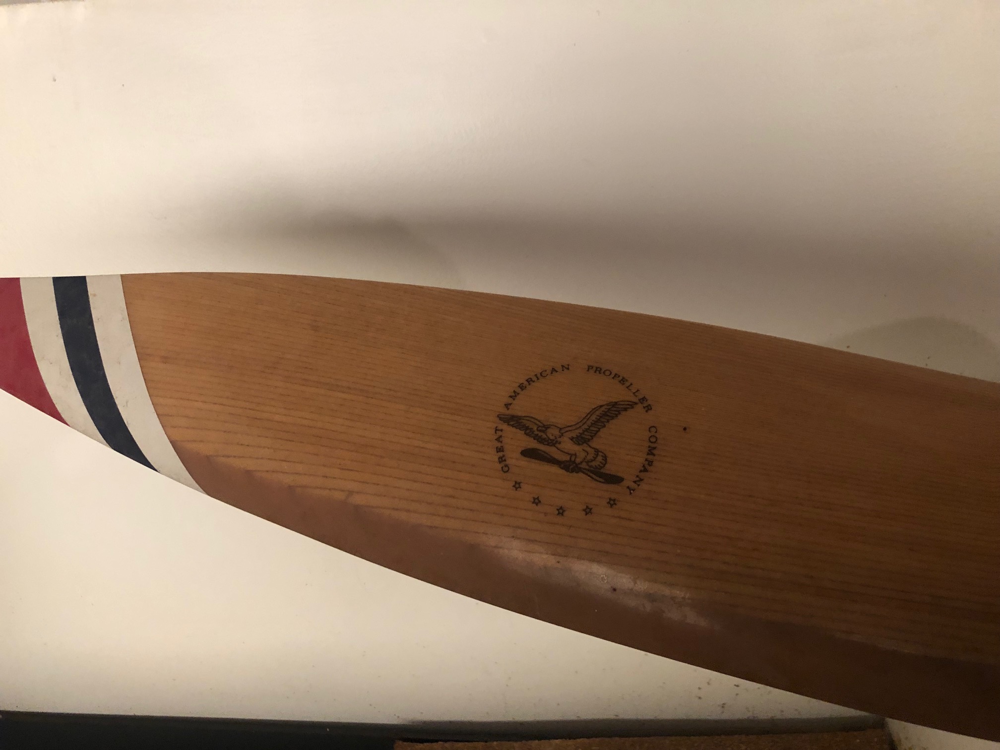

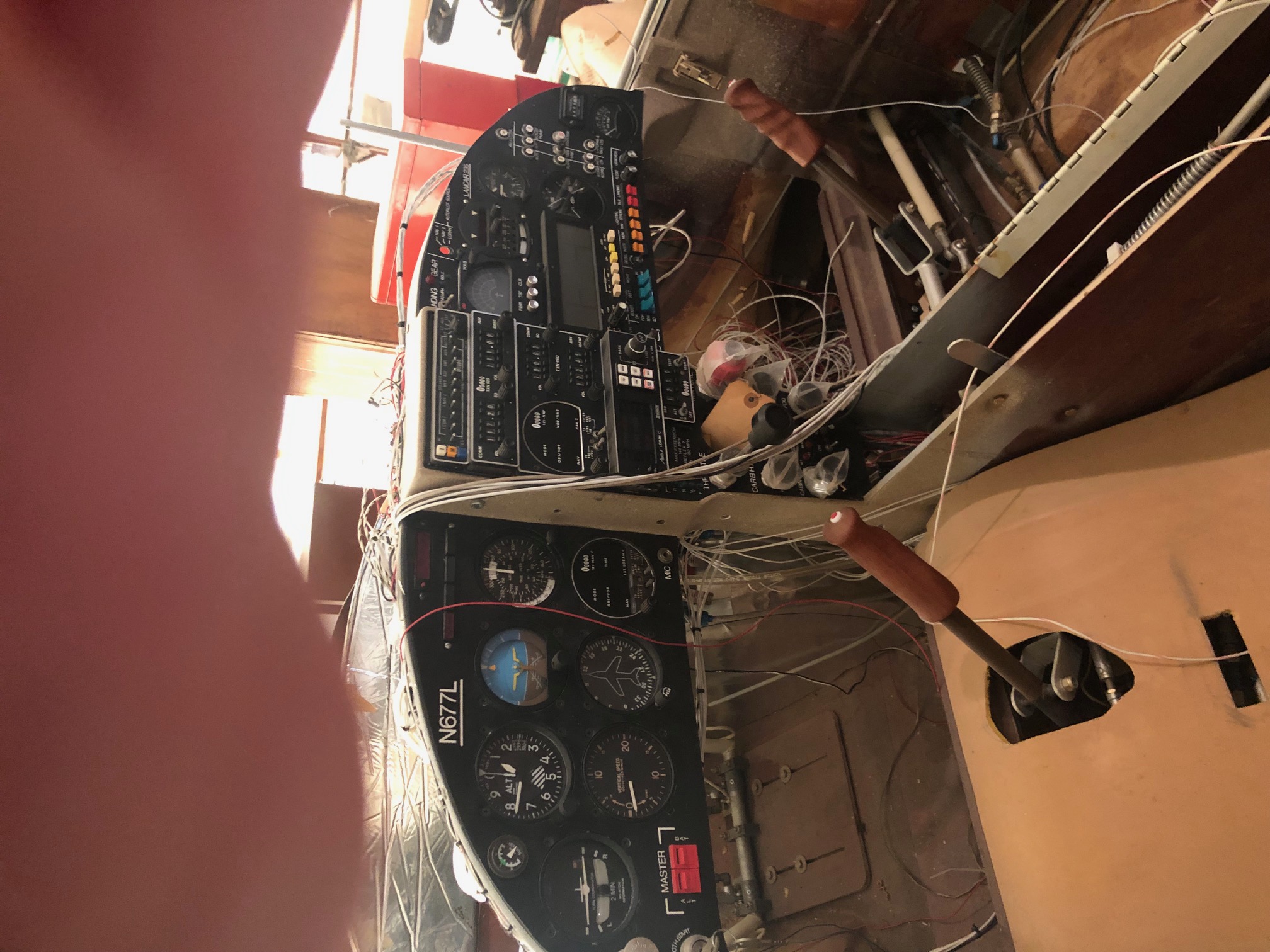

I had an interesting call with a friend of a builder who quit some years ago on this 235 project. Initially, I thought it going to be possibly rough and unfinished. The specs indicate the owner obviously put a lot of time and money into the project. It has been sitting for some time but here are a few pictures to consume on a rainy day.
Thoughts? Time to complete. Value to someone who wants to build? I've suggested get borescope shots and lots of pictures to show parts and manuals and condition. It might get listed here or not but here is a nice project to compare with a flying airplane.

Wow! That's a Great American prop. I flew behind one of those and it performed really well. The aircraft is mostly done but it would take me another year to complete, I think.

Looks like it is beautifully built. I like the detailed lettering on things like the Nav1/Nav2/LORAN switch. Sadly it is well out off date. The panel will have to be re-done. The engine might be rusty or the seals dried out. If the engine is an O-235, I'd sell that and install an O-320. Then it would need a different prop and modified cowl. Maybe a ventral fin and larger rudder.
To me this looks like 1.5 years and $40k on top of the purchase price
