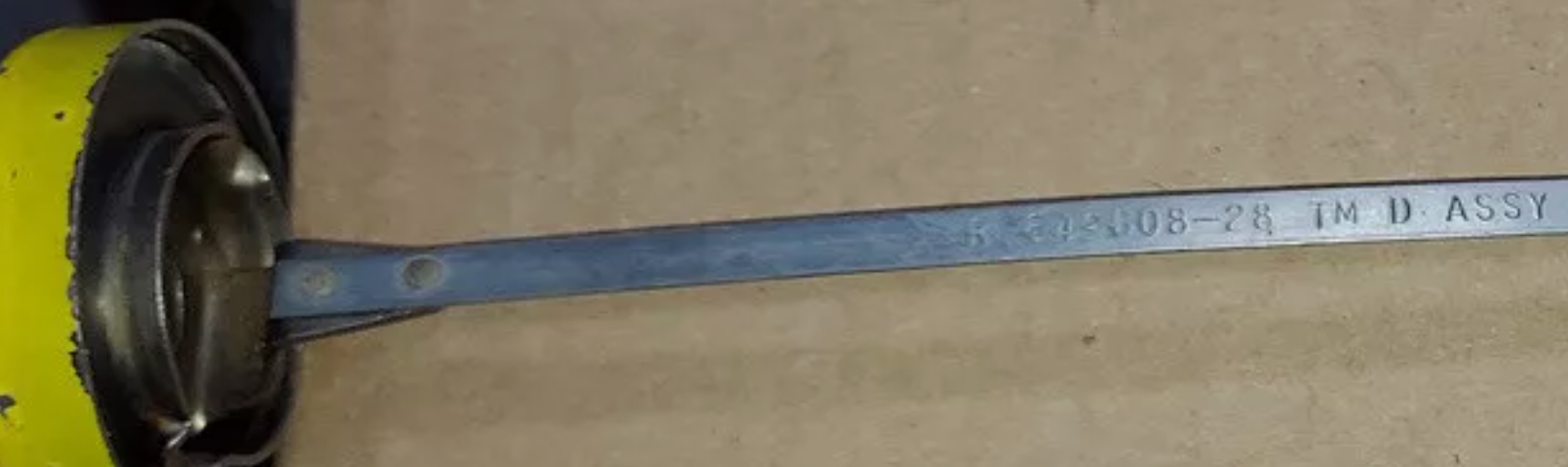

Postby Paul Miller » Wed Oct 23, 2024 3:31 pm
Here is a typical Continental dipstick with markings. I'm guessing it is stamped and riveted to the cap. Maybe it is treated but it feels like spring steel and it flexes in the tube and bends on many engines before reaching the pan.
